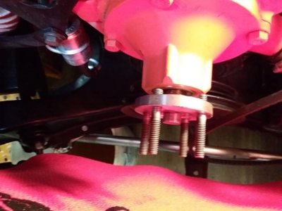

I am putting studs into my water pump housing,( see picture)46506050_1916512585081173_8270694444596985856_n.jpg to push fan closer to radiator .What would be the best/right Loctite to use ?
Thanks Tom C.
Red.
BTW, if you ever have to remove them, a little heat from a propane torch will let you unscrew them pretty easily.

i am not seeing the advantage this will get. won't you have to remove rad every time the fan would have to come out?

I ended use just a little blue, with the 1/4 inch spacer ,pulley and clutch fan about 3/8 inch left for washer and nut
