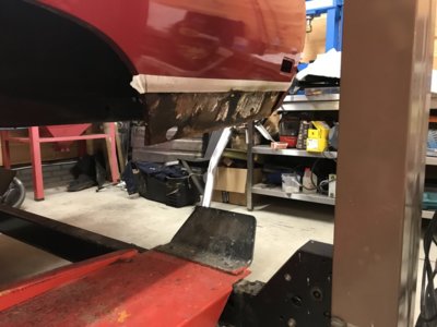

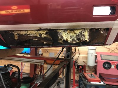

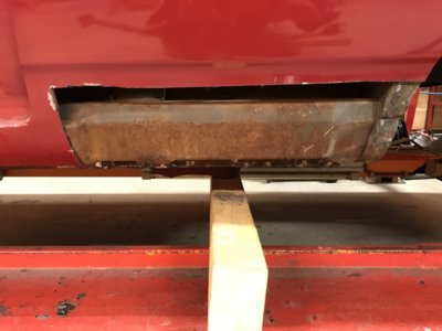

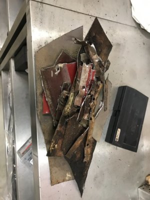

when i bought it looks good but i decide to cut of underpart of the rear fender and under side of mid section
Former owner was a plumber i think went to pur foam what holds water and make it rust i wonder what kind of other home inprovment parts i gonne find ( forgive me my englisch but if
I write dutch ......)
7,704
3,243
What the heck was this guy thinking. Sorry to see this is what you found. Buyer beware. I have a runner that is in my shop now and have replaced about Three Quarter of the car's sheet metal. Had to order a hole inner rocker to replace a piece that was at the back wheel well and under the back pop out window. Too far gone to patch so made a patch panel out of the rocker I ordered. Look's like you got your hands full. Good luck in any language it is bad when you find these type of problem's. :thumbsup:

If I were you Oscar cut along the very bottom edge of the break line then you want have a as noticeable patch

when I did mine the rear quarter on one side had wall plaster then used Velcro to hold it all in .

It is like tressure hunting duck tape sillicone (iron eater!) as long as it is cheap people use it
