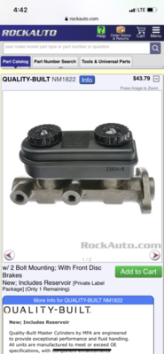

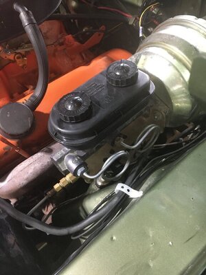

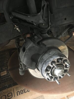

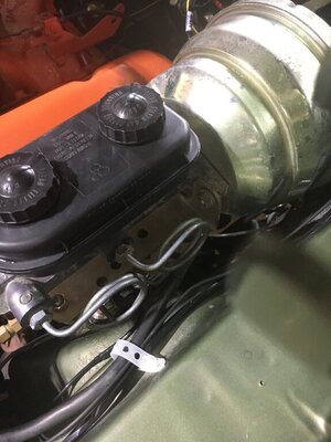

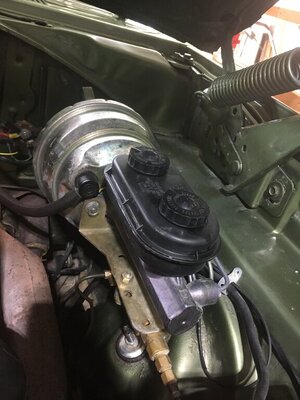

Anyone recognize this brake master cylinder setup? Having some issues from it and need to replace or repair it. Years ago Dad had someone convert from Drums to disc in the front. Both lines from the master to the proportioning valve are the same size. Front rotors measurements are about 10 1/2 inch diameter from what I measured with the sliding brake calipers. Thanks in advance.F11CFE99-D0D2-419D-A99D-8A3CF1FF5F68.jpegC06A701E-0316-41C4-A54D-283EAC43450C.jpeg25BBC2E0-C59A-4DF1-97B9-5089B898FE59.jpegimage.jpg
7,705
Do not think the 70's ones had the plastic reservoir. I could be wrong. Should be a number on it to cross reference it so you can get part's or a new one.
The booster and master are aftermarket, I think Mancini racing might sell that master.

Found out it was a kit from CPP. Waiting to hear back from them to verify what master cylinder I will need. Also confirmed it has the 11 inch discs.

Well I got the 80 master cylinder just had to bore out the mount holes so it would fit. Bleed the master and installed it. Tried to bleed it for a few days but kept getting air. Got a set of plugs for the master and pulled the proportioning valve and went through it. There was a small piece of something in it I believe that was the cause of all my issues. Air/valve not centering for proportioning valve. Got it bleed and will give it a few days and verify it’s all good.
7,705
Yes that is all it takes is a small object to get into the system. Wish you the best of luck and hope you have the problem solved.

Well weeks later and besides all the other issues along the way I found it ended up being a front caliper bleeder that was the air in the system issue. Thing would not seal up even with new bleeder. So got a new caliper a few weeks ago and bleed them and been good since. Never had a bleeder that would not leak but suck air.
