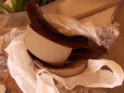

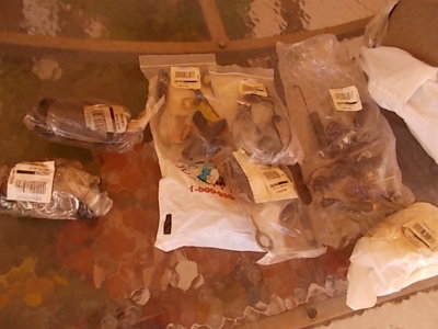

DSCN1385.JPG DSCN1386.JPG Here is what I have
self adjuster kits all 4
shoe spring kit both fronts
wheel cylinders both rear
front shoes 11x3 both sides
master rebuild kit
all from year one which is over priced but we have a Thanksgiving special

69hemibeep......Thanks for the consideration & effort, especially on a Saturday morning. I tried to catch u with a PM before leaving to discuss what u may have. Hope u didn’t make a special trip. Re the shoes, I need the rears. My original WC’s are rebuildable & the hardware is in good shape. Again, I appreciate your effort & consideration. If u were closer, I’d buy u breakfast.........Jim
