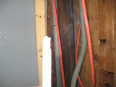

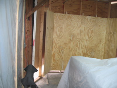

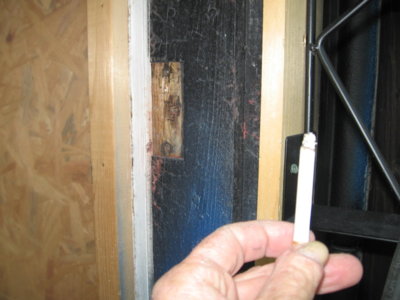

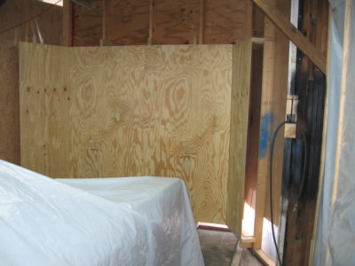

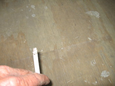

Had a problem in the paint booth to much air flow over my work area. Only place to paint the rest of the parts was behind the car. Was getting to much trash and stuff in the paint. Built this Plenum for down draft and side draft. Now the area where painting is not so turbulent. Hope this solves the problem Think it will. Have the hood and trunk lid left to paint and small part's. So here is some pic's. Smoke test side panels and floor. IMG_0105.JPG IMG_0106.JPG IMG_0107.JPG IMG_0108.JPG IMG_0109.JPG
