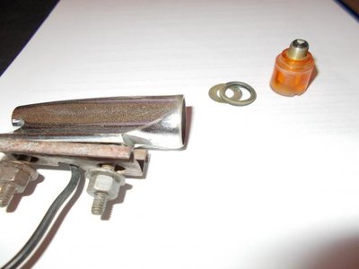

mine are faded, and crusty looking, the driver side works, the passenger side inop. I was gonna order the lenses/bulbs and the guy told me it might need new wires too, that I should disconnect first to make sure? I am gonna WD40 it, and go slow...it looks fairly simple...um like changing a light bulb lol.
Once it is unscrewed the rubber O-ring will try and hold the lens in, I used real narrow long nose pliers or large tweezers to pull it out. I wouldn't remove the signal or wires unless you find it all corroded inside

Mine has the light package and Bob is correct. however I did remove them from the fender, removed the set screw(allen key) and pushed them out the bottom. The wiring does feed on each fender side from the wiring harness. there are disconnects 1/2 way up to the mounting point.

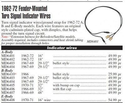

Maybe I need to buy this? One end plugs into the wire coming off the turn signal under the fender and the other plugs into the existing harness??? Just wondering if I need to buy another harness to make it work...

yep that's what it looks like
I think that is the ones from the bullets

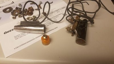

Here is my blinker. It looks like it needs a female to plug into [emoji1] . That other picture looks like the female on one end and a harness on the other. If that's the part I need I just need to find where the harness plugs into right? Or....maybe I'm way off....
Sent from my SM-G935P using Tapatalk
