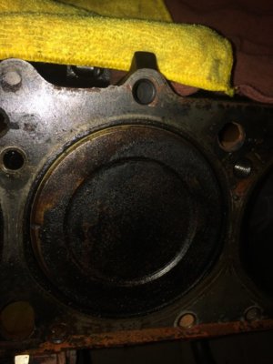

I have the .039 felpro gaskets and I will be having the stock 906 heads worked adding new 440 source Stealth head springs with Comp keepers and retainers. Not sure
what type piston this is but they do not extend above the deck.
