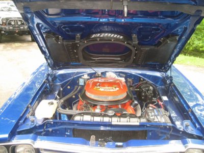

You can see the three speed wiper motor behind the Air Cleaner and how it tilts off to the side so the Air Cleaner lid will fit.
7,704
So do you have to buy a different windshield wiper motor set up to do that. Or Can ours be twisted with out buying something different.
No Russ, the 2 speed motor cannot be altered, you need the 3 speed one
