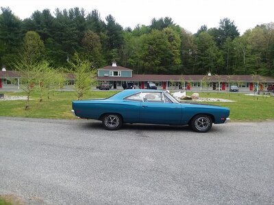

I went with 25.5 inches from center of fender to floor and then a good front end alinement !! I have the hemi leaf springs60670831_2172037349528694_8125376145987207168_n.jpg in rear. the rake seems good to me
