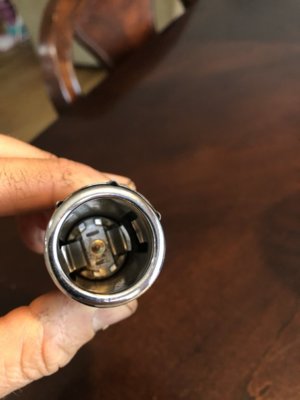

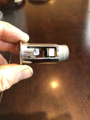

My cigar lighter has never worked so I took it apart and cleaned all of the components and put it back together. I have power to the inside element, but I’m guessing it’s not grounding somehow. Does anyone know how they are suppose to ground? Or maybe some other issue?BD68B693-AE42-4A88-BCDF-06976CEB5A2E.jpeg8776C8E5-3E14-4437-968A-F128B1654178.jpeg

Grounds thru dash. OHM the element see if continuity

Did element ohm good? If not replace element. NAPA should have
