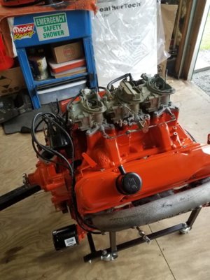

    32621027_1913698015320680_5010980675440869376_n.jpg I went with a 11 inch McLeod in my 69 RR , works great 475HP 500FT TORQUE
