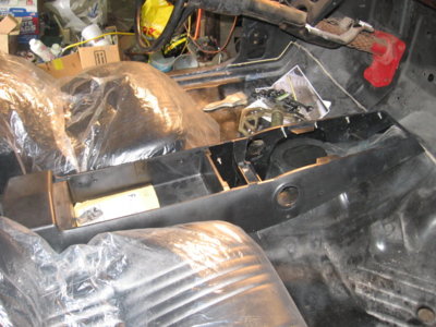

Yea thanks 69hemibeep. Got seat's set in. Steering column set. and placed the seat's and console. For a mock up. Thanks again. Russ.
the rear bracket goes on the seat plate, get that right and all else falls into place.
7,696
3,231

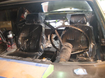

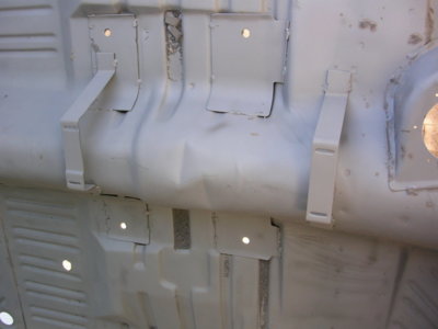

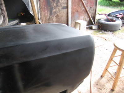

Yep. I just mounted the brackets on the console. Marked them and welded once the console was level. I even got picture's. Thought I had the wrong back plate so order another one. Was I wrong checked again and it fit's so will have one for sale. Also got the seat brackets modified and welded up the extra hole for the bench seat. So here are the pictures. Also quarter extensions done.
how come you've got the driver's seat on the passenger side?
7,696
3,231
Must have had one to many beer's :lol:. Started celebrating the 4th to soon. It will be my grandson's second birthday. :drinks:
7,696
3,231
Their not for moo Stang. Got rid of the Mustang seat's and bought a set of Pro Scat seat's. They fit the cabin fine with the console in place. They do recline. Had to adjust the mounting bracket's two holes next to the tunnel worked. Plugged the out side one not using on ether side. Front and back hole close to the rocker. Just had to weld on some tab's to make them work. Got the seat's from summit racing.
