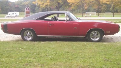

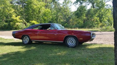

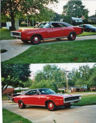

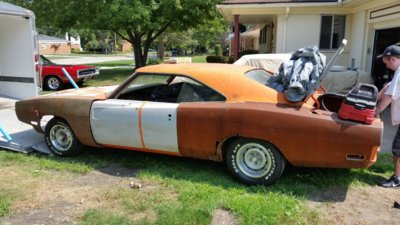

One of my favorite wheels. I switch them up all the time on my Charger and other cars.
