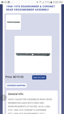

Any one reproduce that weld strip. It fits between the cross member and trunk floor and the tail panel welds to it If you have any pics of what you did to replace it would be appreciated. Russ.
