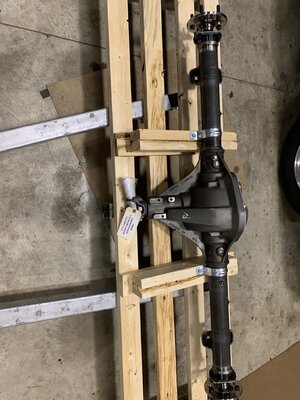

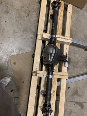

Drive shaft is different. Everything else should be a bolt in swap. I went with the Strange S60 from DrDiff. The most bang for the buck. All new with a 12 month warranty for $2350.

Sydney, Australia
I recently upgraded my 8 3/4/ also, ended up going with the Dutchman housing, only because it was going to cost an arm an a leg to get the strange gear out here. After the stuff around from the local diff shop, I think if I could do it again, I'd go the S60 option. I think Dr. Diff has it listed on his website, pick nad choose options like a shopping list.
