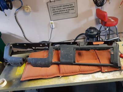

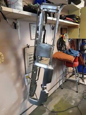

Just about to finish sanding my dash frame. It's a 73 Roadrunner. Would anyone know the colour and type of paint. Went through some forums and they recommend Sem Trim Black.

yes sem trim black is great looks just like original used it on mine

Thanks. Just want to make sure. Trying to find that paint around here is another pain. I'm in Ottawa, Ontario, so anyone knows where I can get this paint.
7,701
3,241
TCP out of CA. It is a lacquer paint. Thin with Lacquer thinner. Shot two coat's on mine and very happy with how it turned out. No rattle can.

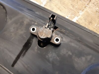

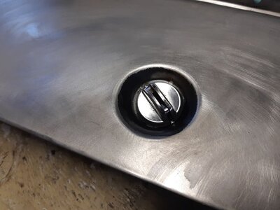

Found some Sem Trim Black in a quart. Getting it delivered today. Now how do you get the lock off the glove box cover to paint it properly.a20210311_124645.jpg a20210311_124651 (1).jpg
7,701
3,241
congratulation. Some things just take a lot of thinking. Other thing's fall in place. So it goes on in the restore of these cars. Hope it turn's out nice. :thumbsup2:
