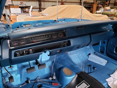

There are blue pads available. Mine was produced by Legendary Interiors. I ended up buying it through Classic Industries rather than directly from Legendary because I got a better deal by waiting for C.I. to have a big sale. It was in stock and shipped right away. Nice quality and made on a steel core like the originals.

Thanks I didn’t see the blue. Your dash looks great. I’m ready to assembled pending the pad, hope mine turns out that nice.
