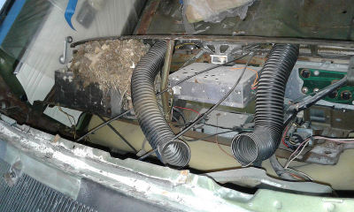

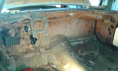

Thanks for the tips everyone. The dash is OUT!!! I took lots of pics and some panning views with video. Every nut, bolt, retainer, fastener is bagged and tagged. Here are a couple of pics:
looks like there is a mouse family that is now homeless......
10,538
281
I was out with my car and had a lot of nest material blow out of the driver's vent. So I vacumed it out through the grates of the vent but it kept coming. I pulled the cover and the stuff kept coming down from the vent. I had about a foot of the vacuum hose in the vent. Don't know if I got all of it or not. Guess I'll find out the hard way. The little fu@ks had already chewed up my head liner and now I know where they took the stuff!
I dragged a '69 Charger R/T in for parts that had been sitting for years. It had a really nice H pipe that I used on my '68 Charger R/T.It was was after dark when I was finished putting the pipe on the car, and I went for a quick ride. I went about a mile, and when I was coming down the hill and let off the gas, there was a neat fire show from the mice nest that had been in the old Cherry Bombs.

Looks empty! Now is time to decide about wiring harness and also absolutely the best time to replace the wiper pivot seals etc.
