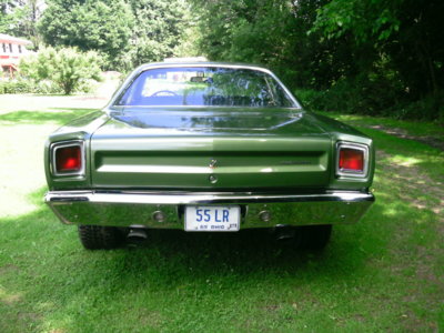

I have holes on the upper right side of the trunk for an emblem. So which one should go their. Is it roadrunner or Plymouth. Well know you guy's know and let me know. Need to buy one while working on the trunk lid. Thanks Russ.

Road Runner I think that the Plymouth went on a Satellite it also gets a standing bird with helmet above the key hole on trunk lid the colored one the black and white one goes on a 68

A Road Runner deck lid will have 4 holes on the right side for the emblems. If it is from a Satellite, there will only be 3 holes and several holes around the indention for the border trim. The decal is the same one that goes on the dash, and it goes in the center of the deck lid.

Don't know where the trunk lid came from. Yes it has the four holes on the right for mounting the emblem's. But also have holes for trunk finish panel. Got to weld those up. It had some minor damage like someone tried to brake into the lock. Also one dent on the right not too bad got them hammered out close enough it won't take a lot of filler to clean it up. Thanks guy's got to get one on the way to check bolt hole's. Russ.

Weld up the 3 holes for the Plymouth emblem as they will not line up with the Road Runner emblems. Yes, this lesson is from the school of hard knocks.
the road runner emblems go to the passenger side, and the road runner decal goes over the lock
