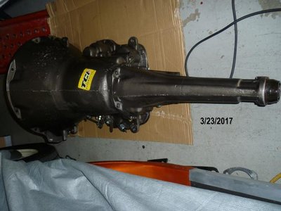

Hi,
Can anyone tell me what this transmission originally came out of-
PK4028412 5678 5159
Thank you in advance,
Mike
vso737
Oct 6, 2013
177
28
California
Is there a VIN stamped on the side or top edge?
PK4028412 5678 5159
The above number is on the SIDE just above the oil pan on the DRIVER's side. It is suppose to be the ID number for the transmission.
I do NOT have any reference books that deal with MOPAR.
Would be nice to know what it came off of.....................
Any assistance greatly appreciated.
4028412 was used in 76-77 Chrysler Dodge and Plymouth 400 v8 non HP
5678= 42nd day of 1977
