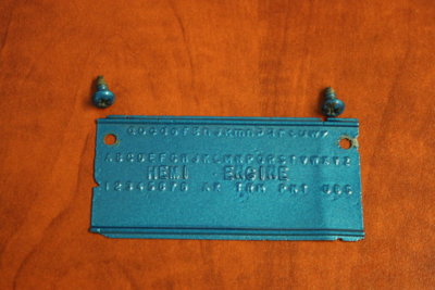

Can anyone tell me what this fender tag represents,,it was placed right next to the normal fender tag on a 1968 hemi roadrunner hardtop??

The other one is not a fender tag, even though it’s on that format. It doesn’t go under hood by the rear fender tag. It went under the carpet on the drivers side in 1967 Hemi cars. I bought a gtx from and older man who owned it since the 70’s and I new the car and it wasnt any kind of a fake. When I took the carpet out there was that tag. I was told by knowledgeable people that’s where the factory put it.
It was never under hood by the real fender tag.
I don’t know if 68 even had them or not. Many changes for 68 like the vIn moved to the dash, the certicard moved from the under hood pouch to the owners manual, fender tag differences, etc.
