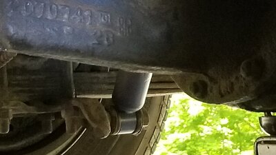

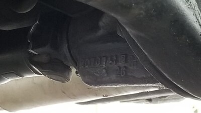

Hi Russ, thanks for the reply. Yes tire on the ground, first left then right and got the same reading on both sides. As suggested I turned the pinion and it took 1.50 turns for one revolution of the tire. Here a pic of the differential.20200524_171448.jpg 20200524_171344.jpg

With both wheels in the air you have to spin the wheel two times to figure the ratio. so the # of spins of the drive line to two rotations of a tire which = 1 for an open diff

Thank you SBSW, That gets it into the ball park. Think I have must have a 2.76 to 1. Thank you for the clarification!
