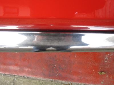

I've tried different chrome cleaners and plenty of elbow grease on the rear bumper but this one piece always looks like this.It's not scratched at all but has a dull finish.The rest gleams like new and is in great shape.Is there a way to improve it?
Nothing can be done except to have it rechromed.
Sorry....
over here in the rust belt we would call that new looking and thank the chrome gods.
Most likely that is in the chrome and not the nickel plate under the chrome. They may be able to just strip the chrome and redo that only.
That could save you some $$. Is there a good plating shop around?

There is,I'll look into it.I'll live with it though if it looks like costing too much £££s.
Steve. I just saw on a restoration show where they took aluminum foil and water and scrubbed the chrome

Steve. I do not know you heard anything about this "pasta goy" it works wonders, just do a search in Google and see the results

I have had good luck with Eagle one and very fine steel wool over the years,my front bumper has never be rechromed ! But like Big John pointed out there is a point where you can't do anything more with it. Sometimes you are better off buying a complete rechromed one here in the states as chrome plating has gone out of sight,however in the UK I realize you have less options.
