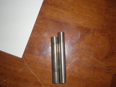

moparstuart
Feb 27, 2009
6,627
J[/quote] get one of the big magnetic drain plugs hughes also carries
but you may have to replace the barings I had to , thought i could get by with just
changing the oil several times and using the magnet to get all the metal out but the motor didnt make it but another 2000 miles and the main barings where shot and the crank had to be turned 10/10
