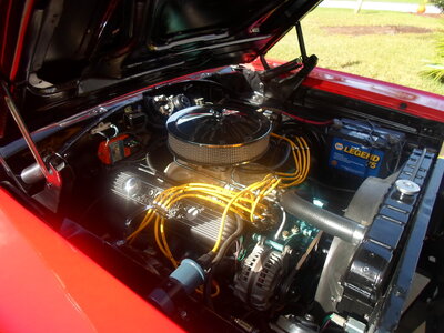

Did you replace the distributor along with the orange box or are you still using the breaker points with it (if that is even possible)?
Mine looks like this.
th?id=HN.608047273716876908&pid=15.jpg th?id=HN.608000415629705551&pid=15.jpg
no, when you add electronic ignition, you replace the points distributer with an electronic one.
