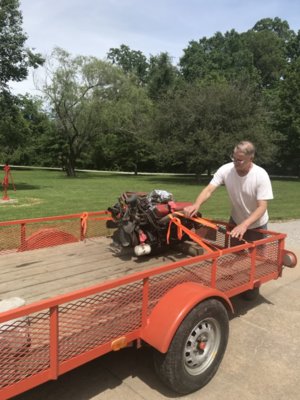

Headed to Baldwin’s Racing Engines. Great reputation! Can’t wait to hear it run again!!!

he is going to put a lot of new stuff in the engine. I told him to put a new water pump on while he had it tore down and put a bigger cam in It. change the valve springs for the cam and check if it needs to be bored or not. I told him it was up to him what he thought. he is going to rebuild the carburetor and take the alternator off and rebuild it I am going to leave the old manifolds on it so it looks a little factory and put a kit in the distributor to change it to electronic so it will still have the old distributor in it for a factory look. he is going to paint the engine for me while he has it tore down. The thing I like the best about him doing it is that he after he is done he puts them on the Dino and runs them to see how they perform and the transmission he takes them to a different place and they rebuild them and he gets picked them up when they are done The transmission is a 727 and it is a good one and he is going to get me a stall for the transmission. I told him I just wanted to drop the motor in and hit the key and it will fire up.
