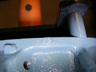

68 blocks would also been found in 69s. There is a machined flat next to the oil pan near the passenger side motor mount, if there are #s stamped there it's a out of a 69 car and might be the full VIN. If not look at the top edge of the block near the oil sending unit for #s stamped into the cast for a 68 car.
