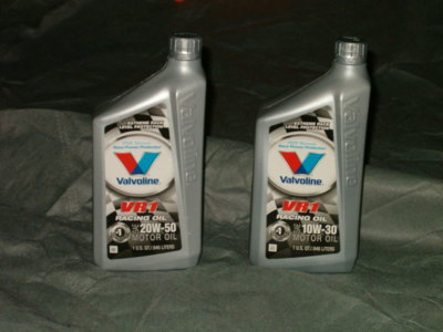

    I use the 20/50 my self HPIM4496.JPG

  4. Blacktop Voodoo
    Blacktop Voodoo Active Member
    Messages:
    43
    Likes Received:
    Joined:
    Apr 1, 2018
    Yep, Valvoline VR1 20W50!
    71RR and CombatMedic80 like this.
