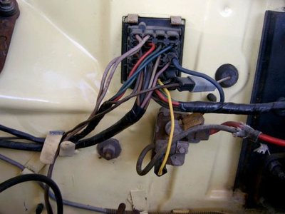

As I recall, my firewall has a dimple where the tach wire grommet should be. I just got my reproduction M&H wire harness from Year One. The grommet with this harness measures roughly 0.860" inch. A 7/8" inch knockout punch measures 0.885" inch which may be about right. I'll test it on some scrap sheet metal first to see how well the grommet seals. It would still be interesting to know exactly what the factory measurement is?
A pic of the factory install ->
