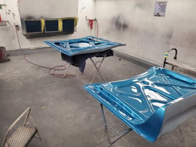

Was area under fender tag just left primer...Tag put on before final color?
Position for the tag.....so it can be read standing at dr side fender?

I would paint them separate just to seal things up and yes place it so it can be read. If you want to get real detailed Lynch Rd. cars had the tag hanging in the car on a wire so the tag got fogged with paint and the screws were unpainted other plants would mount the tag and some would put the one screw in and bend the tag up for paint so one screw was painted one not and the tag had a bend.

Thanks. Thought that but wasn’t sure. We’re going to be in full color late next week.3359F1E9-B694-46FF-B7FE-B6B0298C99B9.jpeg
