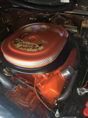

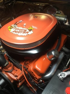

    Well I purchased a 383 4bbl fiberglass air base. Took some work to cut the needed space out of it and get it to fit just right. One pic is of metal base, other is fiberglass... you tell me which

    top is glass.
    what did you have to cut? Mine fight right on after I cut the vent tube off, and fits with a two speed wiper motor.

    I had to lower the height by 1" so I had to cut and re work the opening to sit correctly on the carb
