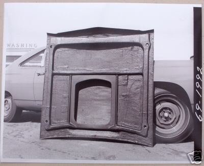

I have the AAR lift off on my car along with the 6bbl. The AAR does not come with the "airbox" provision. You need to build it yourself. For years they have been saying that they are working on it, so you will need to check with them. You might want to give Hybrid Fiberglass a call. He is down here south of Houston. They manufacture many fiberglass products. I've heard that he is considering the 6bbl hood. The 6bbl base plate is very nice. www.hybrid-fiberglass-solutions.com 281-489-7733.
Underside of the stock hood.

Is it very hard to fab up the air box provision? Would anyone have measurements for this?
