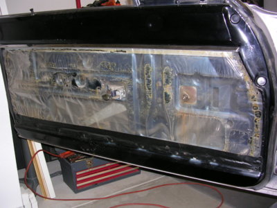

One company Tamrazs say I have to transfer the metal trim with window fuzzy to their panel. I don't have any panels to get this from what the heck do I do. Wonder if Classic Industries has that all ready attached to their panel's. Boy what a pain. Not having any of the interior trim is killing me. Russ. :praying:

The door panel and the "window fuzzy" don't have anything to do with one-another. Two separate items. The door panels tuck up into a piece of stainless trim that screws to the door. If you don't have the stainless trim for the doors and the rear trim panels you'll need to find those somewhere. Get your door panels from Legendary. The cat whiskers (window fuzzies) just pop into the opening in the door for the window. Here is a source (one of many) for the cat whiskers:

So the in side door panel slip's under trim. I will have to check my door's. Like I said who ever had this car striped it. Door panels not their so I assume that the trim is also gone. So is their any thing on the Stainless steel trim between it and the window. Russ.

Nothing between the stainless trim and the window. Just the top of the door frame painted the interior color. Google some pics of a '69 RR interior and you'll see how it fits together.
I know that your car is a post (coupe) model. If it doesn't have the A87 Décor Package, or you aren't upgrading to the Décor Package, the trim should be painted to match the inside of the doors. A87 or non-A87 also determines which style of door panel is needed - if you want a factory original appearance anyway... Your car, build it how you want...
