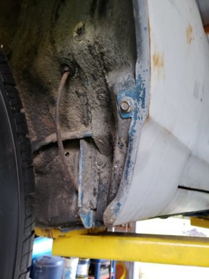

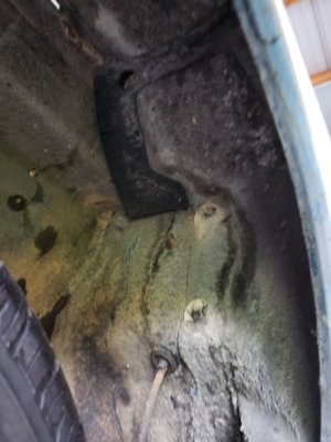

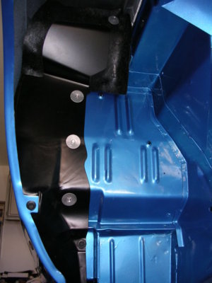

roadrunner restoration 820.jpg Before under coat. There is a gasket against the fender and the one you see on top .

It seemed like "The Picture Guy" was on hiatus...so I stepped in. :D
Of course at this point I only have "Before" photos...
