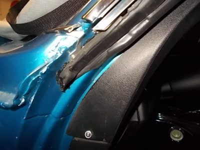

After test fitting the trim noticed the bottom trim goes past the A pillar. Found two stainless steel clips with the wind shield clip's. It look's as if they fit in the end of the trim and attach to the door jamb. They kind of stick out is that natural. I did not have the trim when getting the car. Any thought's would be grate. Or even a picture. Thanks Russ. :BangHead:

That is correct. The bottom trim goes all the way to the outside of the A pillar and attach with a clip and a single screw.

So nothing cover's it like the door rubber seal. Funny that it stands off like it dose not flush. Thanks droptop. Still would like to see picture of it mounted. Russ.

Hey at least he has pics. Thanks Bob. This helps. Looks like I will have to bend them a little. To form to the angle.
