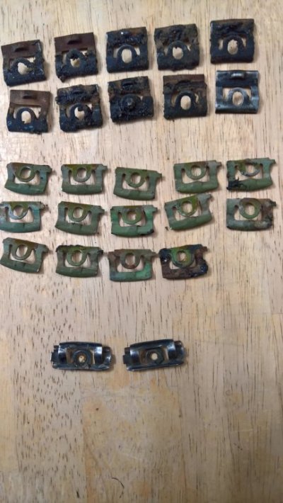

Going to have glass installed and picked up new clips. Compared to old clips and everything looks good but I have to small clips (bottom of pic) and need to know where they go? Didn't take apart so need some help.

The two bottom clips are most commonly found on 68 to 72 A-bodies, specifically the A-Body sedan applications. I think that they mistakenly got placed into your package of clips.

Those are all the old clips that were in the bag so I assume that they came off the car? The new kit came with 14 of the greene clips but I have 16 holes that's why I thought I needed those 2 small clips somewhere?
