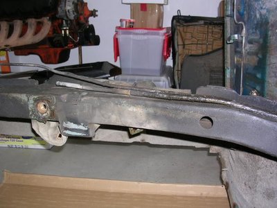

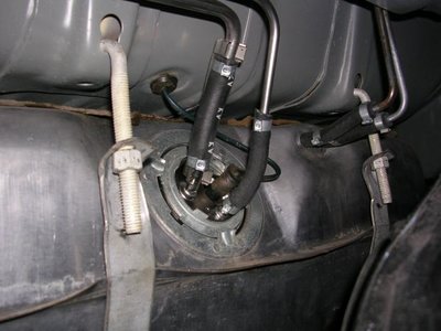

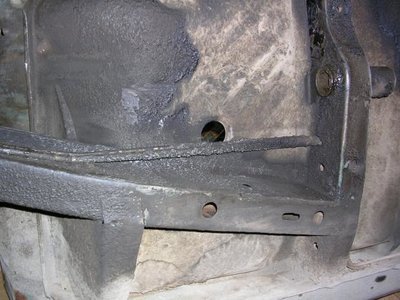

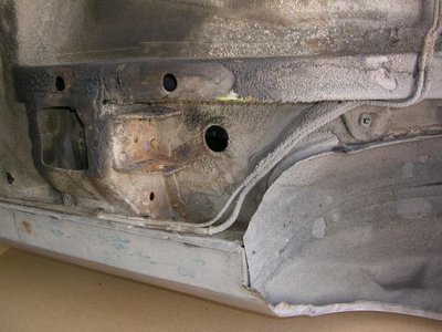

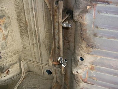

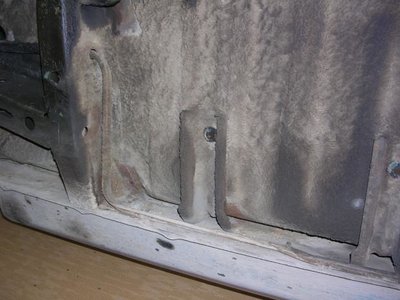

I have a 69 roadrunner with the 383 engine Most of the fuel line was already off when I got the car. Can any one help with the routing of the fuel line from the rear chases to the fuel tank. I have only one fuel line. Pictures would be great Thanking you in advance Bill

Keep in mind this is a hemi car so there is a 1/4 return line you wont have

several companies also make a fuel line that is prebent. it comes back along the pinch weld seam next to the sill plate under the door and then cuts back under the frame rail, ( under as in the ground side, not between the body and frame) just near the front of the axle and then over to the tank
