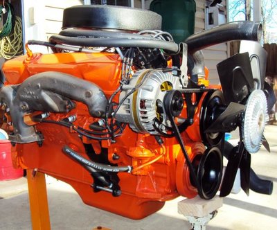

I ordered new lines from fine lines but they are to big to screw into the pump. Can any of you post pic's of your pump to carb lines and sizes of the line connections?. 69 runner, 440 w/ AFB carb

Not sure exactly what your working with, but here's a pic I dug up of my engine resto.... The pump is a stock replacement and the pre-bent tubes are nice repros. Can't remember the manufacturer's name.

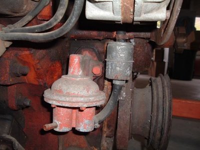

Mopar may have done it a few ways. The following pic is what I found on my numbers matching 69 383 Road Runner. Take note of what is believed to be factory keystone clamps, "KV" hose sections and original fuel filter. The fuel pump was painted Hemi orange with much of it long gone:

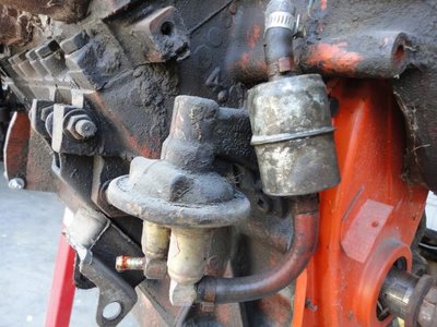

Interesting... Here is a fuel pump pic of an untouched 383 out of a 70 Super Bee. Still looking for a '69 survivor pic...I know I got one somewhere....
