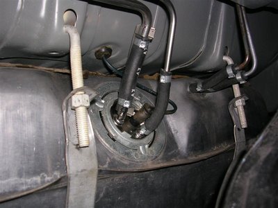

Looking through some spare parts on -ebay- I noticed a listing for a fuel tank ground strap,now I do not have one ,should i have one ,and what does it exactly do,also my fuel gauge does not work,maybe just maybe this is the problem.....
2,352
I think you can see it in this pic. It is on the back side of the main line and bridges the rubber

I was all up in this project last year, and I do not remember a ground for the sending unit. So, I went outside and looked, and sure enough, there is not one. Then I looked at the picture again, and I do not see one there either. ???
I noticed your insulation between the tank and the trunk. Is that original or did you find some of it somewhere? I used some 1/4" water heater insulation (the bubblewrap=like stuff). Anyone see any potential problems with that?

I wish I knew how to circle or highlite things on a pic but oh well. It is the clip at the top and it has a strap the length of the rubber hose and a clip at the bottom, but most of it is on the back side of the fuel line. You could use a piece of wire and two hose clamps to do the same thing. I reused my tank pad as it was in great shape, its basically real thick tar paper

Im sorry, im with Mr.stansbury ,for the life of me I just cant see it...........also what does it do?

the ground strap is on the far left hose . look at the clip on above the hose and below it the connector stap is the wire that goes behind the hose. hope that helps

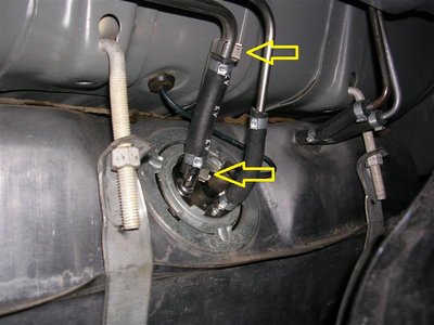

13,675
826
Here is Bob's pic with arrows where the ground strap connects to the fuel line and to the pick-up/sending unit assembly.

I may not do Elvis hair so well, but I can definitely handle a couple of arrows... :lol:

THANKS for the arrows,now that helps,i will get back when ive installed tank ground,maybe my fuel gauge will finally work....

Looked on ebay and saw the strap. For about $15, it looked a whole lot easier to order one than to make one. Looks like the clamps will just connect to the metal line extending from the sending unit and the metal line extending from the fuel tank. I can see the clamps, and that looks right, but I just wanted to make sure.
