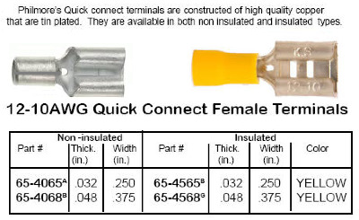

The back side of my fuse box has several places where you can plug in extra wires. They take the terminals show below Check yours to see if it has them also.
Mine does as well but I am not sure it was wired right and I am trying to figure it out. The radio fuse doesnt power the radio when I plug into it. Been trying different fuses like the cigar lighter and none seem to work like they should. However besides the radio all the electrical on the car works correctly.
