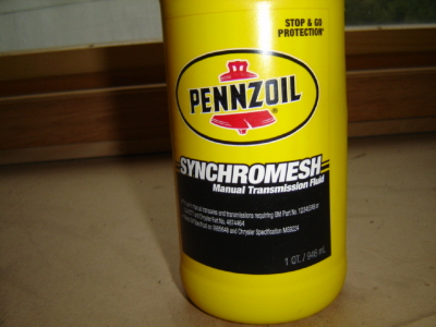

Also anyone changing trany oil read the fine print of the oil. GL5 oil is a no no in our trans. It wipes out bronze and yellow brass in them. GL4 works but is hard to get. Brewers uses StaLube made by CRC. I do not know if any other oils are available or not. This is just a notice to get you to look before you buy. They should tell you on the container if it works on yellow brass and bronze. Big Mo

I used the Sta-Lube and it shifted like molasses in January with gear clash in a gears until warmed up. Switched to Penzoil synchromesh fluid and it shifts like butter.
