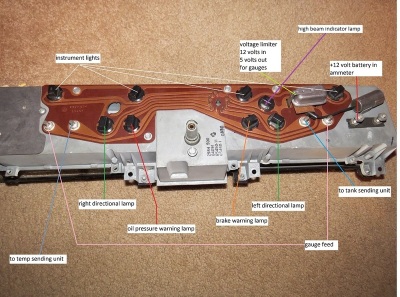

Hi Bob since my gas gauge isn't working nor is the instrument lights or the bulbs on the back of the instrument board, do I connect a ground to one leg of gas gauge and the other to the dash frame

none of the gauges or indicator lights work? i would concentrate on getting those working first.
2,352
Tooo many issues, have you pulled the round plug off the back of the instrument cluster and tested for voltage for lights and continuity for gauges there yet? You will need a diagram.

I have checked the wires in the plug the wire for the gas gauge is not hot but the instrument wire is can't get to the orange wire cause my hand is to big and it's on top of plug so what do I do

if you ground the gas gauge it will always read empty. the sending unit provides the ground and the variable resistance you get when the float moves up and down relates to the movement on the gauge. so no, do not ground the one terminal on the gauge.

I just got done with the same issues as you have. Yeah hands to big so I pulled the IP cluster and found the pins loose for the round plug. Got a new board with the solid state Voltage Regulator and all is good now. Hookup the plug to the cluster as you are snaking back in,no way I could get it on once installed. Hope this helps.
