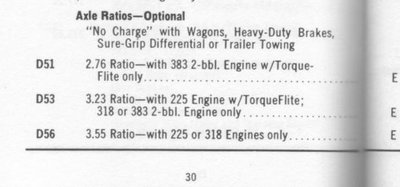

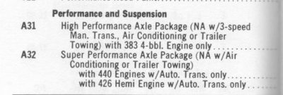

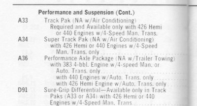

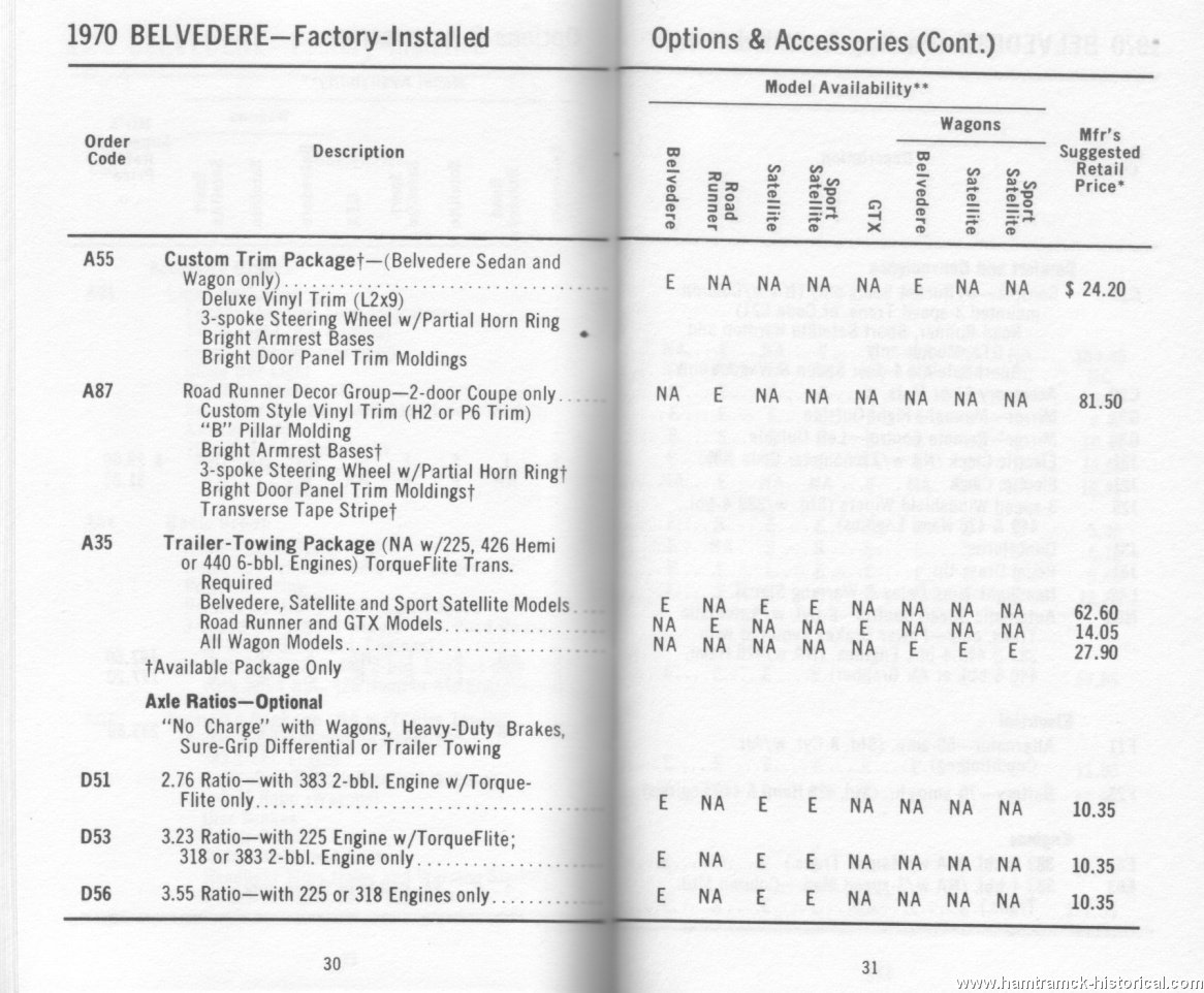

quick search found this but it may not be all inclusive for optional gear ratios outside of the performance axle packages.
from hamtramck .. salemans' pocket guide http://www.hamtramck-historical.com/images/dealerships/SalesmansPocketGuides/1970/Pg 017.jpg
Good info! Looks like a 3.91 was not available for the GTX! No wonder my 383 with the 4.30 rear would toast all those GTX's with 3.23's and 3.54's!
