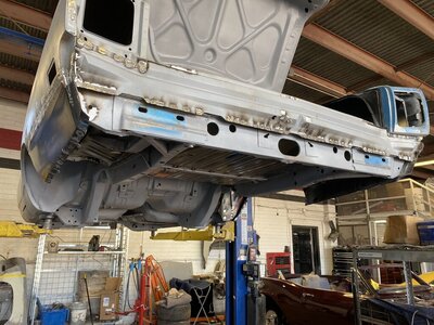

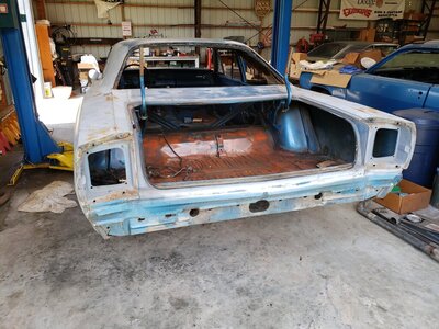

Has any 1 seen a Cracked rear panel
dmartin
Aug 30, 2013
952
344
That’s a new one on me, kind of looks like a stress crack that you usually see on a weld

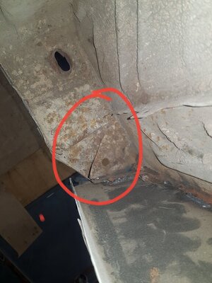

Yes look's like a stress crack to me also. Guess that is why they sell those pieces. Mine where not broken but where replaced when restoring the car due to rust. Look's like you could just weld it up put some metal behind it to help form that happening again.

Agree on just welding the backside and running a bead on the front then grind it down and that is all that needs done

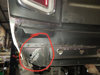

After looking at your pic. It looks like the weld popped loose from the quarter should have been welded to that piece. Give it a little more support.
724
Unibodies flex and will crack at the weakest point. The rear panel as shown, the top of the quarters at the doors, and where the a pillar meets the cowl are the most common places. 4 speed cars are normally worse but it depends on how spirited the driver is. My GTX is an automatic and had cracks in all 3 places as well as where the rear springs attach. Yes it has had a spirited life. LOL.

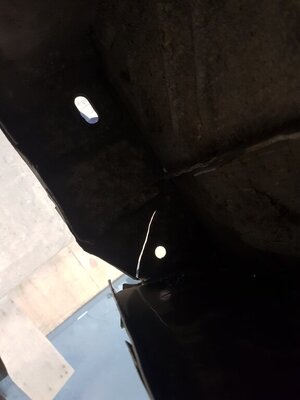

My shock tower has a small crack started. Like most of say it was due to using Air shock's to raise the back end up. Instead of the spring's carrying the load the shock's where. Was not bad enough to replace the tower so welded it up. Good luck on the resto. :thumbsup2:
