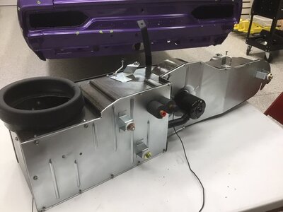

I need to start working on my heater box for the '70. I was wanting to know what most did to refinish the fiberglass shell? I don't want to paint it black. Seems like you could scuff it with Scotchbrite to rough up the surface and then spray a semigloss clear. Hopefully that would look like factory.
Thanks!

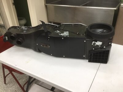

All I did to the fiberglass box was took it outside and washed it down with wesley's White and a scrub brush and then used a sponge on it with some soap and hosed it all down and it looked pretty good. I didn't spray anything on the fiberglass box itself, but all the metal is sandblasted and painted.

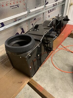

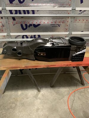

After many hours of work, finally got my heater box ready to rip. I went full out and pulled the cable brackets off and zinc plated those as well as the many sheet metal pieces that were installed as bare metal. I was able to just scrub the fiberglass and recoated with SEM plastic semi gloss clear. Just need to put the part number stamp on. Movin' on.
