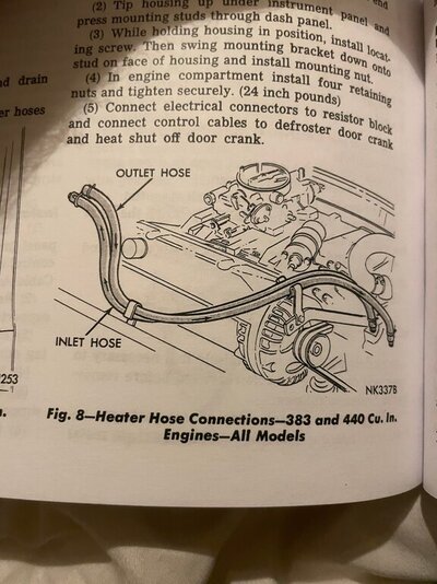

Thanks for the info Ranger. Now that know where the heater hoses go & the stock radiator has both outlet on the driver's side, that will help me a lot. I'm guessing the cars equipped with the "Max Cooling Package" or A/C had the upper hose on the passenger side. P/S, the heater hose bracket location is very helpful also. Believe it or not, I found both of them too. Thanks again for all your help on this.

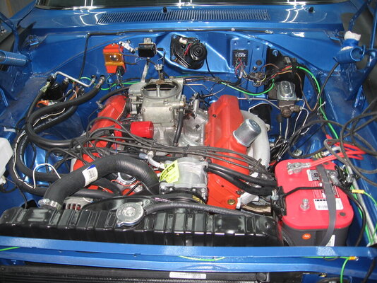

Not positive, but I think you might be right. I also think those might have had a 26" radiator as opposed to the 22" in my picture.
