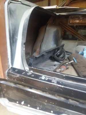

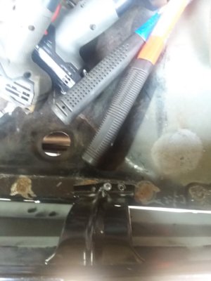

I need some pics of the area on the tail panel, where the taillight box and trunk gutter meet at the tail panel, I believe I put together last week right, then put it together wrong, currently I have the gutter piece ending up behind tail panel, see my pics, but I posted a mistake in projects that was probably right. Show me the correct view of the gutter meeting the tail panel, also i have a mock up of the tail panel braces screwed to trunk pan, id appreciate a pic of where they weld to pan.. Help

You are correct. The tail pan goes under the gutter. I just installed the amd tailpan myself and the brackets in the bottom picture look like they are where they belong. I twisted mine to square them up as my originals were parallel with the seam between the trunk floor and tailpan.

Thanks for getting with me on this,I got her screwed in place for welding now gutters where they were suppose to be Thanks
7,704
My pieces set out on the out side of the tail panel for the rain gutter by tail light box. Still have mine that I took off in one piece. The bottom lip went over the tail panel and was on the inside of the tail light box. Hope this helps. Still cleaning the trunk braces. Hope to put it together next week. Russ.
