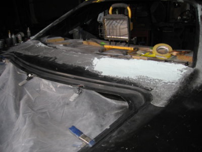

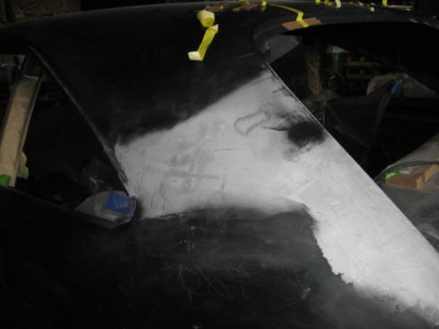

All the body filler at the back window. Just about when I think I have it have to put some more on. Due to the after market metal have to fill to bring the edge up for window trim. On the quarter and the roof marriage ended up using a piece of 1/4 in fuel line to pull the body filler. Used a sweeping motion from the rain gutter to the back window. It worked better than trying to use a putty blade or the bond O type blades. So here is a few pic's. IMG_0103.JPG IMG_0102.JPG IMG_0101.JPG

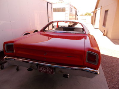

Just finished the stainless or I'd take pictures of the clip locations

How did the trim fit the edge's. Have done test fit with clip's and have found gaps in the bottom corner from the glass. The trim is a little high their. Still tweaking it back their adding a little and sanding a lot. With the test fit the top trim is just below the roll in the metal so trying too make the bottom and side's do the same. Thanks for the pic's of the trim clip's. Will make note of it to my computer. How about a pic of the front clip's also. Dusty Rusty. Oh got the pic saved but don't see the bottom clip's sorry.

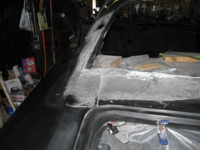

Just for jest of it the line between Dutch man's panel and the quarter or should I say gap. Had to fill it and will recreate it after the filling the area is done. Noticed the line out side of the trunk lip on the quarter is leading a little in due to the filler and the after market metal so it has a little curve to the roof line at the back window. Don't see any other way to make it look rite. Thank you guy's for all the encouragement and tip's it is well appreciated. The job is a little tougher than it look's till you get in up to your eye ball's. Now where is that beer think it is 5:00 O clock some where. :lol:
