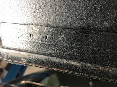

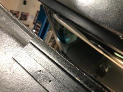

I looked at mine (took pics) might have to see what you have. The pictures of mine show 2 small holes on the outside with the clip on the inside. Couldn’t see how they attached. I’m certain someone on the forum will answer your question.

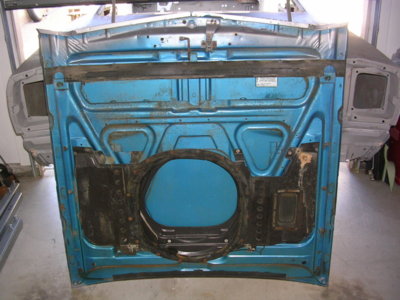

The seals I get have the clips in them. Look at the bottom of my hood for locationroadrunner restoration 439.jpg
