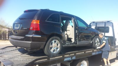

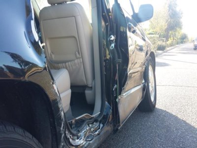

Progressive bought the car and took it away. Well played Harold LOL20191105_120449.jpg
